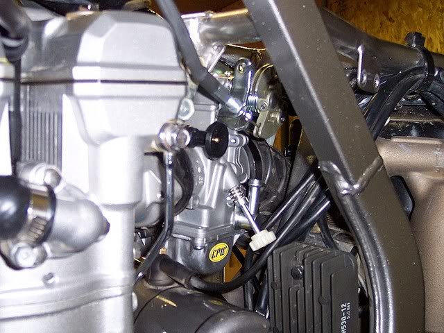

I figured that since I've come this far, there no sense in giving away power now, so I ordered a Mikuni TM36-68 pumper carb from Carb Parts Warehouse. The TM36 doesn't need adapters front or rear to fit the KLX, and it is the same height as the stock carb. It's 1/4" shorter front to rear than the TM34 from Bill Blue, so it literally falls into place, but there's still enough rubber over the spigots to seal up well.

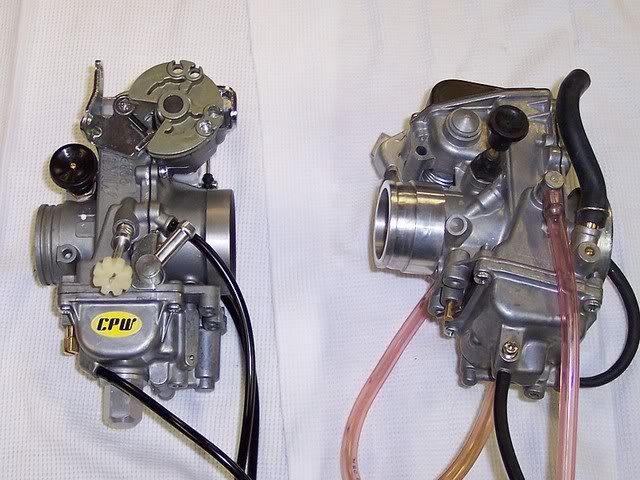

The TM36 is on the left, while the TM34 is on the right. Since the TM36 is an aftermarket-only carb, everything on it is adjustable. You can adjust throttle spring tension, accelerator pump start and stop positions, and the air/fuel mixture screw can be adjusted by finger tip. The big nut on the bottom covers the main jet. You can change main jets simply by rotating the carb in the bike and removing the nut.

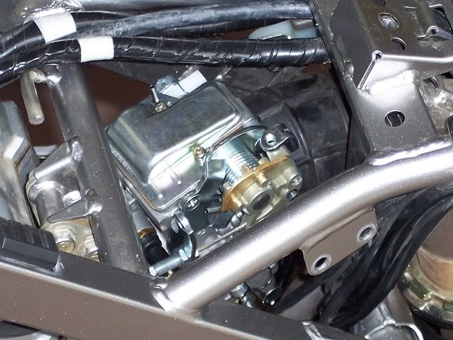

Right out of the box, the carb fits well and can be used with the stock tank with no problem (I checked). With the Clarke tank though, the top of the throttle wheel hits the tank. The throttle cable bracket could bebent a little so that the cable flows over the head better, but it will work as-is.
After somegrindingoff the top of the throttle wheel, even the Clarke tank works. Nothing else needs to be modified.
It's actually even easier to get to the idle adjuster too. The TM-36 uses the same style jets as the TM34, but much smaller sizes for some reason. I'm now running a 15 pilot jet, a 130 main jet (compared to a 42.5 and a 142.5), and the clip on the needle in the 3rd slot from the top. Throttle response is crisp, and the bike will rev to redline without any surging or bogging whatsoever (with the airbox lid off). The low-RPM snap isabout the same asthe TM34, butmid-range and top-end power isstronger.
