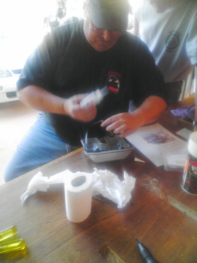

Superglued on the left side at the 4 corners and the inside curve.
The gasket is like $30..what a load of crap. The thing was literally too small for the groove. I don't know who designed it but the groove should be on the bottom, not the valve cover itself. Either way the gasket was too small.
The jetting needs work...but that's another thread. The new 2009 Muzzy looks good and fits OK. The turn signal is completely unaffected. It won't melt.
Leftover mystery bolt too. Love that.
Not me in the pic. Very good helper!
