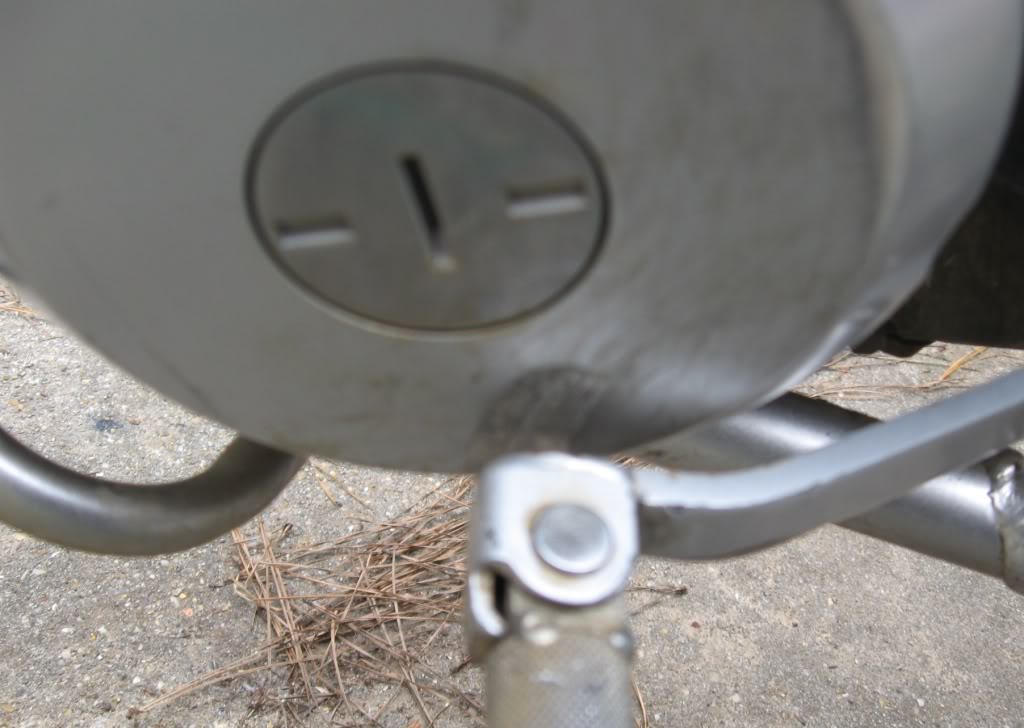

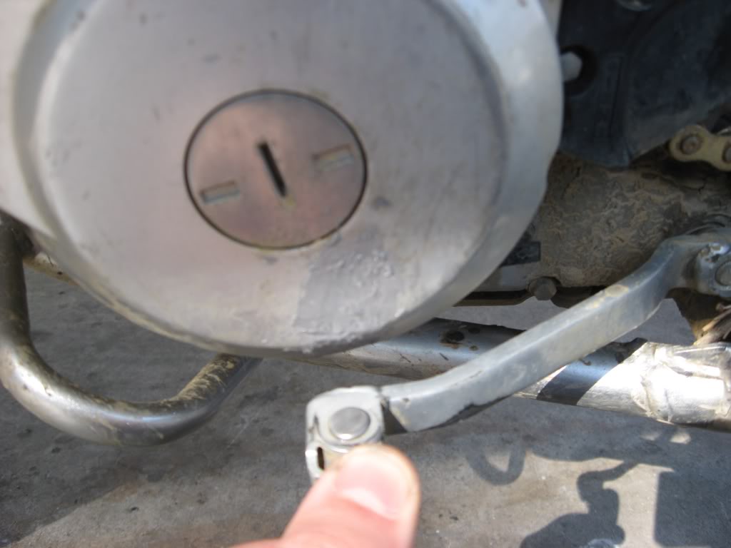

May remember I had an issue with the side case:
![Name: case.jpg
Size: 89.5 KB](https://www.kawasakiforums.com/forum/attachments/klx-250s-71/22238d1501293784-productive-friday-getting-ready-big-ride-weekend-case.jpg)
Well a slab of JB Weld later:

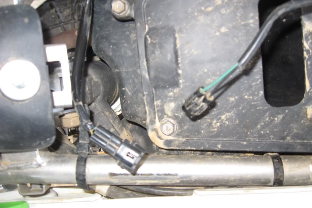

And since I was in the tinkering mood, I pulled off the kickstand safety switch. It still worked, but it was holding about a pound of mud and dirt and pinestraw, and I"d rather be safe than sorry when we're 30 miles from home with no truck.
The '09 isn't as simiple as the '07-back to bypass. The two wires on each side are actually in a plug instead of individually connected.
![Name: switchunplugged.jpg
Size: 77.2 KB](https://www.kawasakiforums.com/forum/attachments/klx-250s-71/22240d1501293784-productive-friday-getting-ready-big-ride-weekend-switchunplugged.jpg)

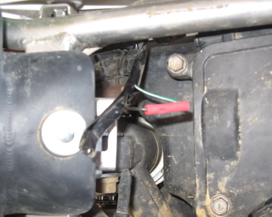

So I pulled some wire out and snipped the connector, and spliced the wires together, and then wrapped them in electrical tape and stuffed it down in the hole.
![Name: splice.jpg
Size: 64.5 KB](https://www.kawasakiforums.com/forum/attachments/klx-250s-71/22241d1501293784-productive-friday-getting-ready-big-ride-weekend-splice.jpg)
