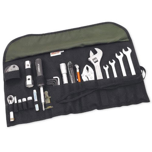

Last year prior to my first trip to Phoenix to ride the fire roads and dirt trails with a friend, I purchased a nice tool kit made by Cruz. This became the starting point for my "flying" tool kit. I also carry it with I'm riding my Kawasaki Versys.
Cruz Tools Roadtech M3 Metric Cruiser Tool Kit - Street Bike - Motorcycle Superstore
