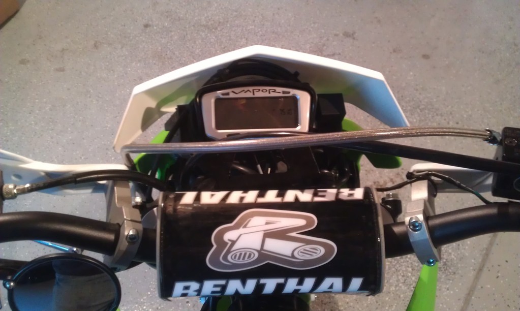

Finished up mounting the Vapor, made a bracket that mounts to my bracket i made for the head light. I think it came out pretty good. I mounted the speedo pick up to the fork guard and had to epoxy the magnet onto the brake rotor after having a clearance issue with the supplied rotor bolt and the fork. Also since my bike only had a tiny RC Car battery on it to power the lights i wired the vapor into the ignition but i am thinking of wiring the Vapor into the headlight power instead. It will be more efficient for battery life.
