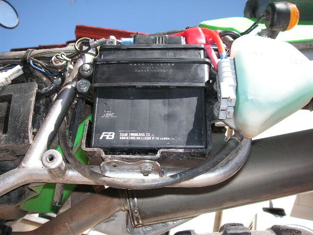

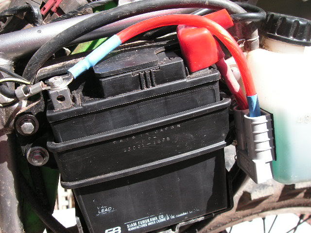

First thing was to install an Anderson plug onto my bike.
A good spot to mount it was onto the water overflow bottle.
This spot can be accessed without having to remove anything.

The plugs will handle 50 amps continuos and the wire I used 60.
That should be enough to give the extra umpf required.
I will make a suitable connecter set up to suite the other model bikes I regularly ride with.
Another KLX will be first.
