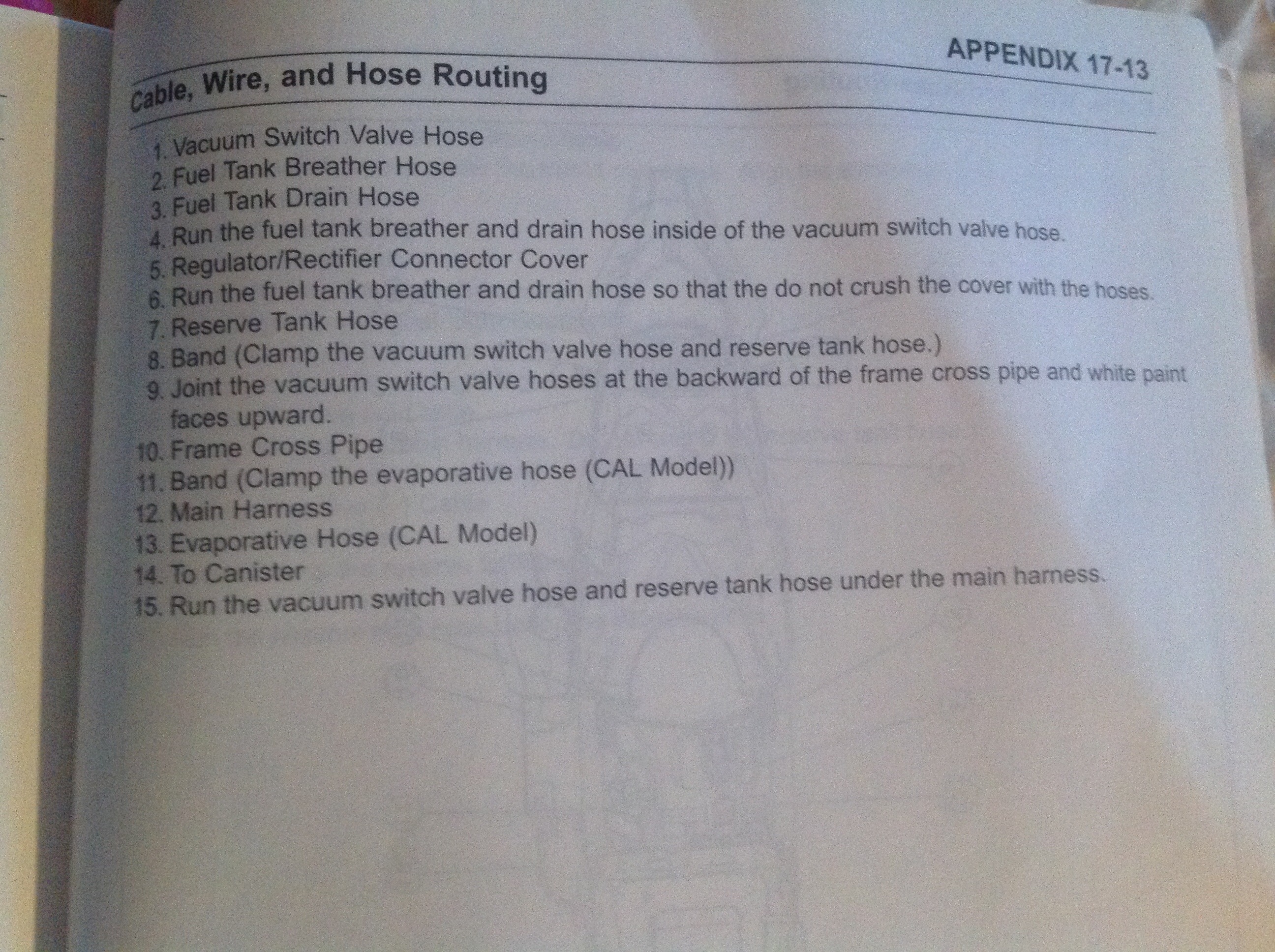

Service manual description

Originally Posted by RaceGass
whoah what manual is this? mine doesn't have any of this ...
I don't think the manuals I have are even for carb'd KLX ...even though they say theyre for "2009 klx250s"
the manuals I have talk about EFI
what about the carb hose what is that?
any reason besides tipping the bike , why these would smell like gas after a ride
I only see two that come out and hang to the bottom... mine has three (four included the hose that goes to the carb , but three hoses that hang down in the swing arm)
