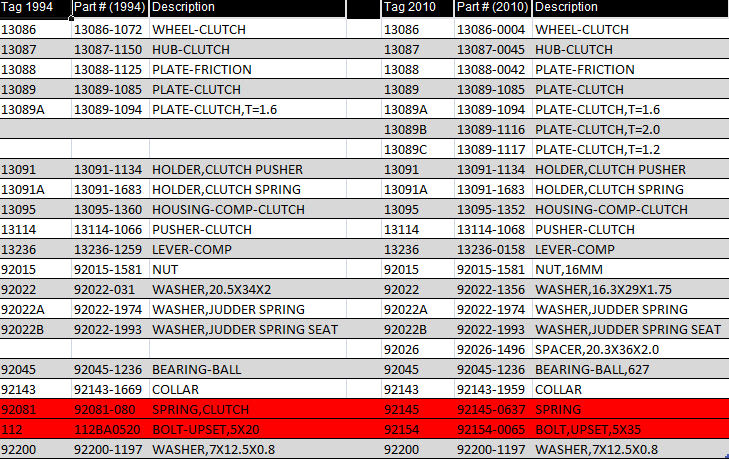

So I've done the side-by-side comparison of the 1994 clutch parts to the 2010 KLX250s and this is what I came up with (I have circled different part tags in red, and highlighted parts that are on one model but not the other in blue):

To me it looks like the clutch assemblies are almost identical (assuming the differences in washers is insignificant) except for the clutch spring and a bolt. But I have an untrained eye. When I look at the detail in the parts list I get concerned though as there are differences:
e.g. Tag 13086 - Wheel-Clutch the 1994 part number is 13086-1072 while the 2010 is 13086-0004
Can anyone tell me whether that is going to be a problem? Does the difference in part numbers mean the parts are significantly different? Or is it just a case of a minor change in number every year even though the part is essentially the same part?
Any/all help would be most appreciated. I really don't want to make an expensive mistake if I can help it. Thanks.
