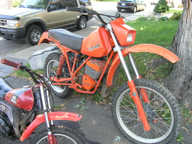

Hey Al, to link to pics in photobucket just copy the IMG code under the pictures in your album,and then paste the text in when you post. The pics will show up once you post it. Hope you don't mind I put a couple of yours up here. Dan
Al's pics
