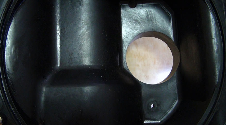

Air box detail
Air box detail

Now take a look at the inside of your air box at the spigot entrance...SHARP CORNERS!
The KLX250 air box is quite different from the previous generation's air box/boot configuration, with it's large-mouthed flange connection to the air box and larger connecting tube to the carb. Maybe that's where some of the KLX300s extra HP came from
I don't think it's possible to retrofit a KLX300 air box to a 2006 and up bike, but some mods can be made to the sharp cornered entrance way. Too bad, it'd be an interesting comparo.
If I was in the US I'd order a proper sized short velocity stack and afix it to the inside of the air box after removing most of one side of the stack. But from this distance it's too much trouble.
The least I'll do is attach a plate with a nice full radius blending up to the edge of the spigot hole in the flat areas above and below the spigot. Flow bench operators make do with just using a plate with rounded corners (1" radius recommended) attached to cylinder head intake ports so that seems to be the quickest and easiest fix. As does the air filter in the YT AEM video above.
Just take off the rubber boot and put something the same size OD as the spigot ID in there to locate the plate as the JB Weld is setting up and it'd be a quick installation.

Well I've started making an insert to smooth out the sharp cornered intersection where the air box body meets the spigot..
Luckily I ordered some tan Alumilite resin mix over a year ago (slow set 7 I think) and finally can put it to use.. It's very lightweight and easy to shape afterwards
It's only 3/4" thick but it's enough to play with
This pic doesn't show it, but the contouring is coming all well...almost like it'd been shaped by water flow Just a little more and it'll be ready to JB Weld in place. If I get ambitious I may bolt it in instead, but I don't see a reason to go to all that trouble..There shouldn't be a need to take it out again.
I'm going to try and hold off on installing it until I do some timed runs without it, so I can go back and look for the improvement but...I may just get bored and put it in.
I don't see it making the bike run any worse with it
